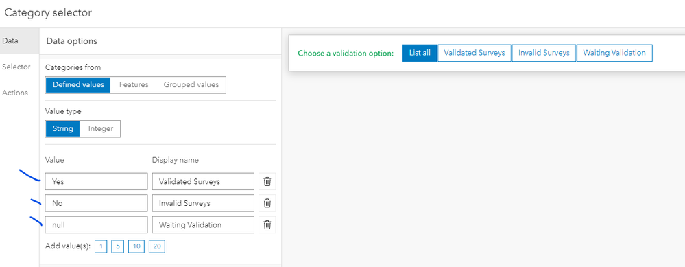

Hi Joe et al on this thread......I was trying to make this same idea happen, then found your posts.  I have a Survey123 Connect survey (editable) embedded in an internal review Dashboard.  The Survey is completed by residents and provides information on their water service line, as part of our lead service line inventory program.  Once the survey is submitted, we review the information internally, and select 'Yes' if we conclude the service line is properly identified (validated) or 'No' if we conclude we need to investigate further (invalid).  The field remains "empty" in the survey attribute table until we select yes or no.  I would like the Category Selector to List All, Validated Surveys, Invalid Surveys, and those Waiting Validation.  The last category is the one in question - how can I list only those survey records still waiting our review?  I am guessing I may have to add a "null" choice to the yes/no choice list in the Connect XLSform, to get this to work.  Any other ideas are welcome.  I did upvote your idea. Regards, Jay
One of my many iterations......clicking on 'Waiting Validation' returned 'No Data' in the element.
