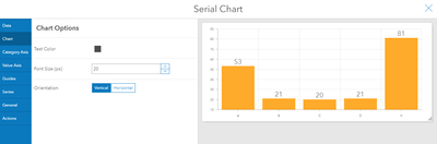

@LJackson29 Serial charts allow you to control the size/color of labels on the Chart tab during configuration. Further refinement (e.g. change size) can be done on the Category Axis and Value Axis. Is there something else you need? Also, can you provide more info on "just show the number and not the category label"? (depending on the answer, we might have to consider that as a separate idea/request)

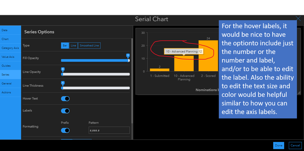

Thank you for following up. I am referring to the labels associated with the Series on a Serial Chart. You can not edit the size or color of the labels associated with the series bars or the hover text associated with the bars.For the series labels, you are able to format how the number appears, but you cannot format the hover text fields. In the example attached, I would prefer to just show the number, as the series label is redundant and busy. It would be nice to have the option to include just the number or number and series label. See attached photos.  I would also like to be able to actually edit the category labels. As you can see in the attached, the data was created with the category number followed by the label. I am not able to change the actual data, but it would be nice to edit the label so it doesn't have the category number at the front. dashboard series labels.PNGHover labels.png

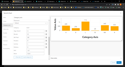

There are a few ideas in this short thread. Ideally, they'd be separated to be voted on individually. I am going to close this one, with the following information to be considered ...
Category labels can be edited in two ways (i.e. two ways that do not involved editing the underlying data).
1 - Manually, via the Category Axis tab at design time:
2 - Via a data expression
The size of the labels on the bars/columns on a serial chart is controlled by the Font Size setting on the Chart tab.
