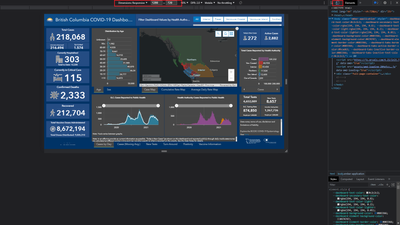

In the meantime, a tip: If you have a high resolution monitor and know a dashboard will be displayed on a monitor with less resolution, some browser developer tools (e.g. Chrome) allow you to toggle a device toolbar and set the resolution.
