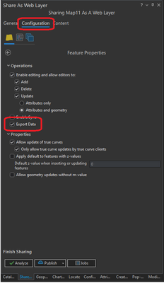

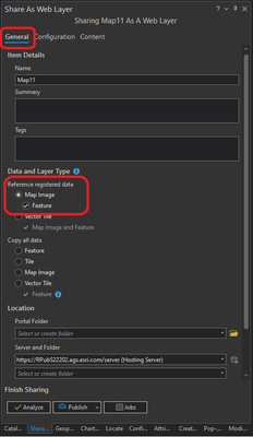

The ability to perform the download is controlled by the back-end services themselves by an 'extract' capability (i.e. if a service layer does not have this capability, download source data is not enabled for the dashboard element). This capability is enabled for hosted services via the layer item details page setting Allow data exports. For referenced services, you need to ensure you enable the Feature service extension and also check the Export Data box when publishing (or overwriting) a web layer. A dashboard element that references one of the feature service's layers/tables should then allow download of source data (if not, please work with Support to get a BUG report submitted).

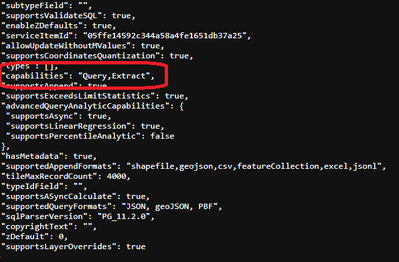

Behind the scenes, you can look for a service layer property named capabilities to see what is possible. These properties are explained in the REST documentation
