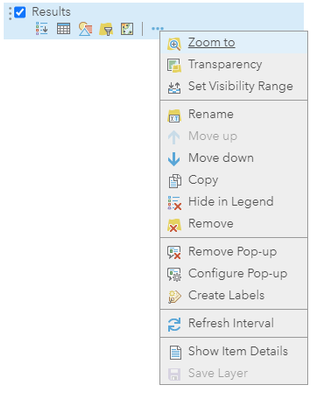

@CrystalMcDermott1 If I understand correctly, I think this is already possible by following some steps.... The layers you bring into the Map Viewer should all exist as standalone web layers. One these layers, you can set the popup info via their item page. When these layers are brought into the Map Viewer, you can leave the popups as-is for all but one layer. For that layer, you should choose to Remove Pop-up (the Map Viewer is now 'overriding' what is stored in the layer)

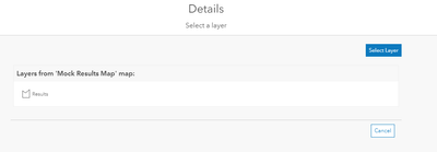

When you add the Details element to your dashboard, do not select the layer that is stored in the web map (it no longer has popups). Rather, click the 'Select Layer' option and choose the original web layer (it's popups will still be there).
Let us know if this does not work.
