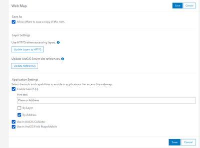

Hello jcarlson.  I am familiar with configuring search in a Web Application, but I see no option to configure search in the Web Map from which a Dashboard is created.
jcarlson
Go to the web map's Item page (not the map viewer) and go to the Settings tab. Search settings are there.
DanielL
Thank you! I don't think I would have found that in a million years.  Unfortunately, I still see no option to use a custom locator.  Am I still missing something?
But being able to configure search on individual layers should get me what I want.👍
