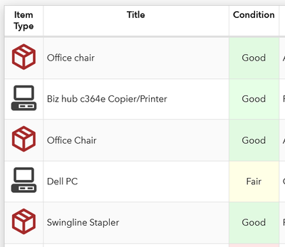

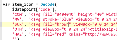

If you want your icon centered in a table column, or you want multiple colors, etc., you can actually just pipe in raw SVG into the displayText.
