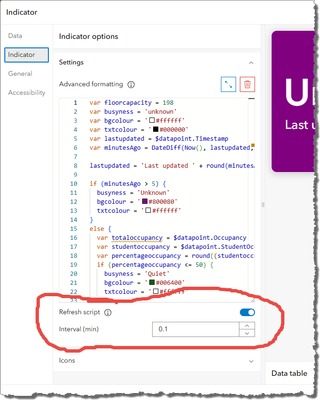

Hey @JenniferAcunto, great article and really helpful to something we're creating at the moment to show live occupancy of libraries.  One thing you don't mention in your blog post is the 'refresh script' setting that is found if you enable the Advanced Formatting option on an Indicator Widget:
I created a Dashboard which used a standalone table as it's data source (not in a map).  Tables don't have a 'Visualisation' tab, so I couldn't set the refresh rate on the item itself.  I'm not using a Data Expression, so I couldn't set the refresh rate there either.  The 'refresh script' toggle was the only place I found where I could set some sort of refresh value.  But toggling this one, and setting the refresh to 0.1 minutes didn't do anything.  The data in the Dashboard never updated.  I ended up having to put the table in to a map, and set the refresh interval on the table in the map.  This works fine, and the Dashboard now updates, but I'm confused as to what the 'Refresh script' control is meant to do.  I'm wondering if you could add some clarification about this setting to your blog post as it seems relevant to the topic?
JenniferAcunto
That is what is outlined in the blog under the Arcade Advanced Formatting section. That setting just refreshes the arcade, not the data behind it.
MappyIan
Thanks @JenniferAcunto, I can't believe I didn't realise that section was about the 'refresh script' setting [facepalm].  For the scenario I outlined where we have a Dashboard that uses a standalone table is there any way to get the data to refresh without having to add it to a map and set the refresh on there, as this seems a bit redundant?
