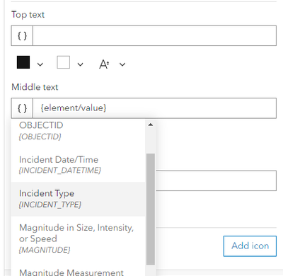

When using attribute data, you do not need to use the quotes, so be sure to remove them before adding your attribute. I always use the Globals pane to add my attributes. That way I don’t have to worry about getting the syntax correct or any typos.
Globals for the winGlobals for the win

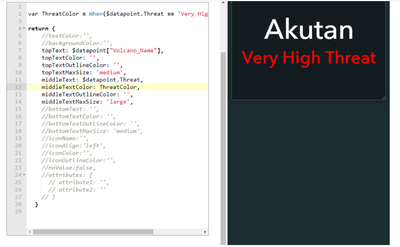

While the alert level has a color value assigned in the data, the threat level does not. If we want to focus on the threat level and have dynamically changing colors that highlight very high threats, we will need to use Arcade to do so.
I’ll start with a simple when statement. When the threat level is Very High Threat, give me red, otherwise leave it blank.
When($datapoint.Threat == 'Very High Threat', 'red', '')
Arcade ExpressionArcade Expression
We have our Arcade statement to dynamically change the color from the default to red when the feature has a Very High threat level. However, we can’t use it anywhere yet, because we have not assigned it to a variable.
Let’s assign it to a variable called ThreatColor.
var ThreatColor = When($datapoint.Threat == 'Very High Threat', 'red', '')
Now wherever we want to use our dynamic color, we simply add ThreatColor. Because it is a variable and not a hard-coded value, we will not need to include it in quotes.
Arcade Statement with VariableArcade Statement with Variable

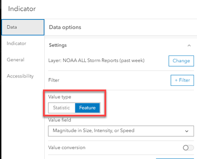

Hello very interesting your article as I just need to create an indicator that shows the level of risk but I try to follow the steps and I find that I do not know how to generate the indicator to read a text field, ie, I need to replicate what you do here.
I have doubts because in the arcade expesiones only allows me to set a $datapoint of type Value. Could you help me?
JenniferAcunto
@DanielLeónPacheco
You need to set your Indicator Value type to Feature. Pick any number field in your data to set as the value field.
Then on the Indicator tab, replace the value field with your text field.
You might want to change the maximum number of features displayed to 1, so you don't have the arrows to flip through all your data.

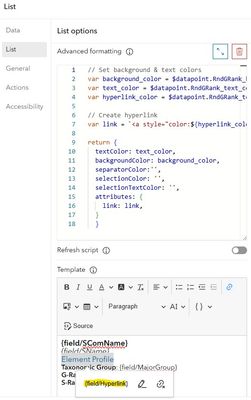

Thank you for this blog @JenniferAcunto! I've set up conditional formatting within the Dashboard List widget to control the background and text color based on an attribute. I did by setting a field for "background_color" and another field for "text_color" specifying the hex codes, which is then configured using advanced formatting. The list includes a field with a hyperlink based on another field. The text color for the hyperlinked text does not appear to follow the conditional rules configured. Is there a way to set the hyperlink text to follow the same advanced formatting rules?
JenniferAcunto
@Ellie_Linden

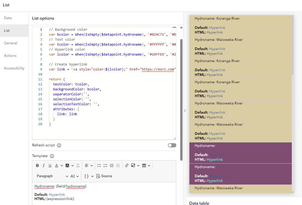

You would need to create the hyperlink HTML in the Advanced Formatting and return the HTML as an attribute to do so.
// Background color
var bcolor = When(IsEmpty($datapoint.hydroname), '#824C71', '#DCCCA3')
// Text color
var tcolor = When(IsEmpty($datapoint.hydroname), '#ffffff', '#000000')
// Hyperlink color
var lcolor = When(IsEmpty($datapoint.hydroname), '#26FFE6', '#264653')
// Create hyperlink
var link = `<a style="color:${lcolor};" href="https://esri.com">Hyperlink</a>`
return {
  textColor: tcolor,
  backgroundColor: bcolor,
  separatorColor:'',
  selectionColor: '',
  selectionTextColor: '',
  attributes: {
    link: link
Ellie_Linden
Thank you so much for this @JenniferAcunto! I'm able to replicate the example above where the hyperlink navigates to the Esri URL. In my case, the hyperlink is also dynamic, where it pulls from a field in the table called "Hyperlink." I think set the hyperlink for the text in the "Template" section to be {field/Hyperlink} (screenshot below). How would the code need to change in this case given it's not a static URL?
