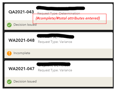

Really, what I want is to be able to use Arcade to just pop out a number of null attribute fields which I could add into a custom list. Then, when staff are looking at the list, they could see records that require review. I suppose I could accomplish this directly in Survey123 by adding a read-only field with a calculation of some sort that would count completed questions, however it would be nice to accomplish this without changing the survey form. I just do not know if Arcade can even do something like this.
Something kind of like this:

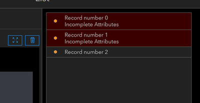

Oh, totally! You can do that with the Advanced Formatting in a list. Say I've got the following features:
att_1 att_2 att_3 att_4
Yes IncompletePending
 Complete Complete
NoCompleteCompleteIncomplete
In the Advanced Formatting, I can alter my list on the basis of any of these. Suppose I want to flag "null" attributes, I might do this:
var atts = [
    $datapoint["att_1"],
    $datapoint["att_2"],
    $datapoint["att_3"],
    $datapoint["att_4"]
var incomplete = Any(atts, IsEmpty)
return {
  backgroundColor: Iif(incomplete, '#3a0000', ''),
   attributes: {
    warnings: Iif(incomplete, 'Incomplete Attributes', '')
erica_poisson
This is great! This is the final result for now:
Thank you! 🙂
