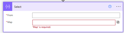

Swap your Select from "key value mode" to "text mode":
This will ensure you just get the IDs
bbaker_tngeo
That was exactly the issue. I was able to complete the workflow after modifying that action per your feedback. Thank you!
