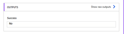

Using the Add Attachment action in Power Automate, I am getting Status Code 500, which indicates a server issue.
"body": {
        "success": false,
        "message": "AxiosError: Request failed with status code 500. "
This flow was working fine until last night, and nothing has changed on my server. I am also able to manually upload this file to the appropriate record myself:
I'm not sure what the issue would be on my end. Is this an Esri issue?

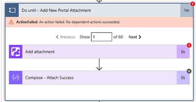

As mentioned, the 'Add attachment' step, but specifically for the Enterprise connector:
It's in a Do until to try until Success equals true
This is the extent of the explanation I get (raw json above), so not much to go off:

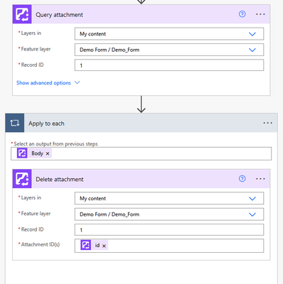

@abureaux That is weird, Can you share a screenshot of your Add attachment inputs. I am curious because, your delete attachment is working.
It could still be uploading/ creating a file that is somehow blocked.

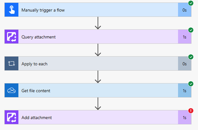

From the simplified test I set-up. All I am doing is getting a file, and then trying to upload it.
Again, I can manually upload a file to this same FL. And in this same flow, I can even Query Attachment and Delete Attachment successfully:
It really is just "Add Attachment" that isn't working:
