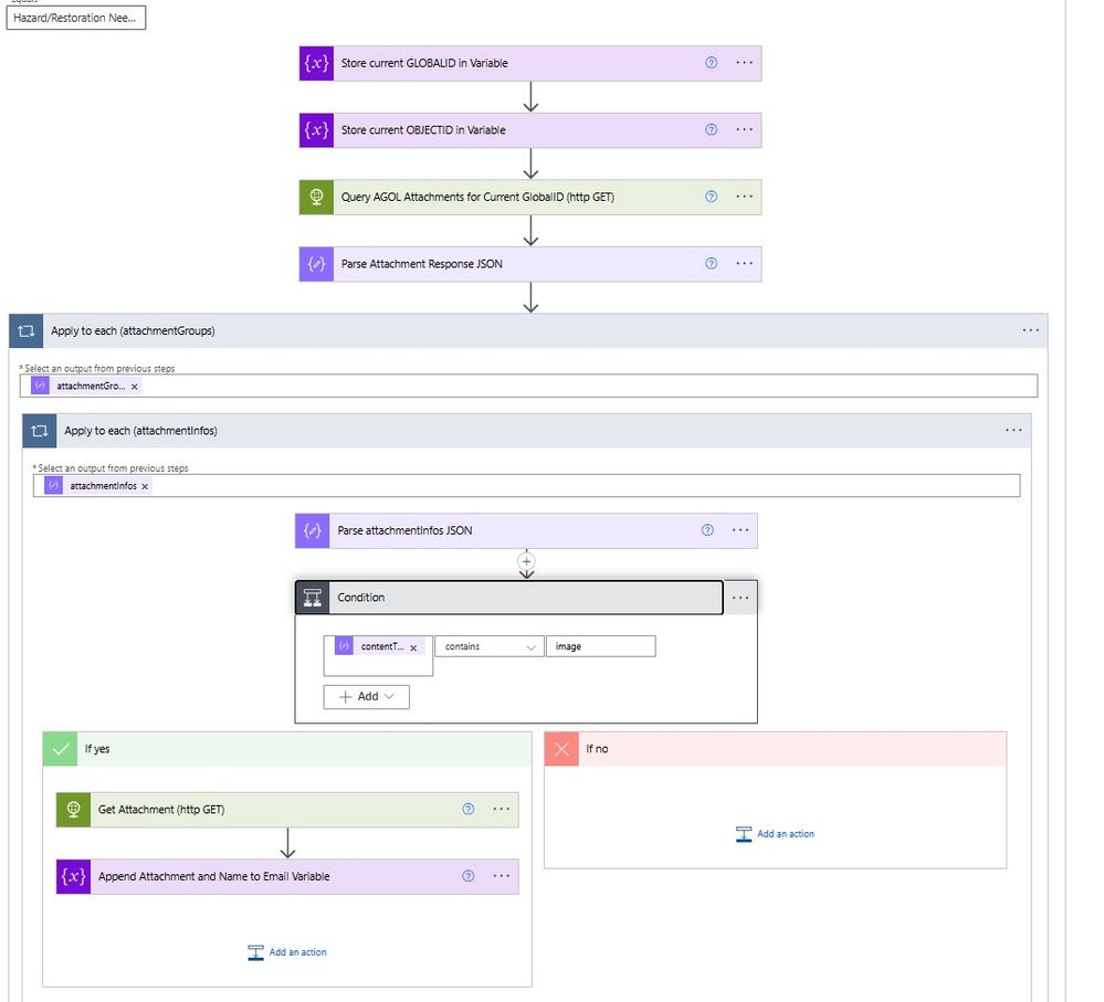

We ran into this same issue and were never able to figure out how to query attachments from either an ArcGIS when a feature updated or created trigger.  Hopefully Esri considers this for an enhancement to work similar to the Survey123 triggers which make it easy to get attachments in Power Automate.
Our workaround was inspired by @jcarlson's post in this thread to use an http call to AGOL REST service to get the list of attachments for the record, then get the attachments themselves.  This was fairly easy to implement:
