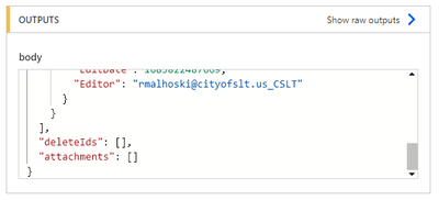

I am trying to author a flow where when a record is added to an AGOL hosted feature layer, I pull the attribute information and the attachment (photo) and email them to someone. Right now I use the When a record is created in a feature layer trigger then use the Fetch updates, changes, or deletions from feature layer action. This grabs all the attribute information, but will not return any attachments. The response shows an empty array:

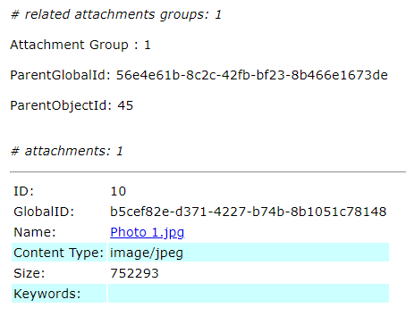

When I use the REST endpoint of the service, I can see the attachment:

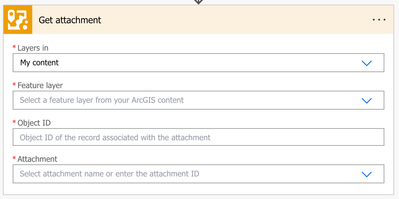

I tried using the Get attachment action and it's greyed out since there's no data getting passed:

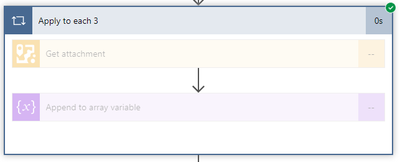

Are there any tutorials on how to include Get Attachment into a "When A Record Is Created" email flow? Every time I try to add this action it creates another "for each" loop and doesn't work.

What about the attachment parameter which is mandatory?

I have the same issue with the attachment parameter, can't get it to work properly.

I figured out what the "Attachment" should be.
I hard-coded the Object ID (14) in this step.
Then, the attachment field will automatically give me the files associated with this item.
This is good, but if I were to use a variable in the Object ID field (such as within a loop), then, the Attachment field cannot find the files associated with the Object ID.  Thus, this "get attachment" is not that useful at all.
