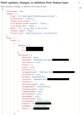

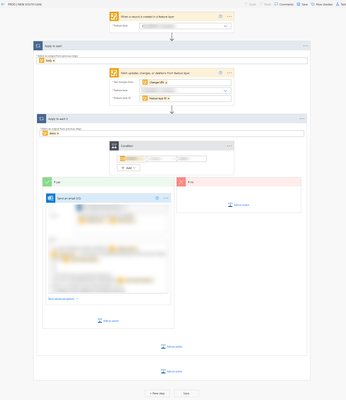

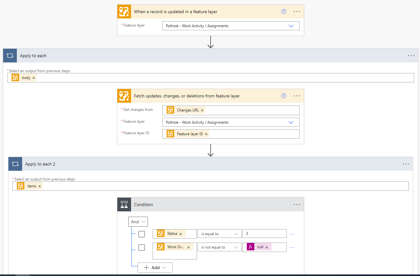

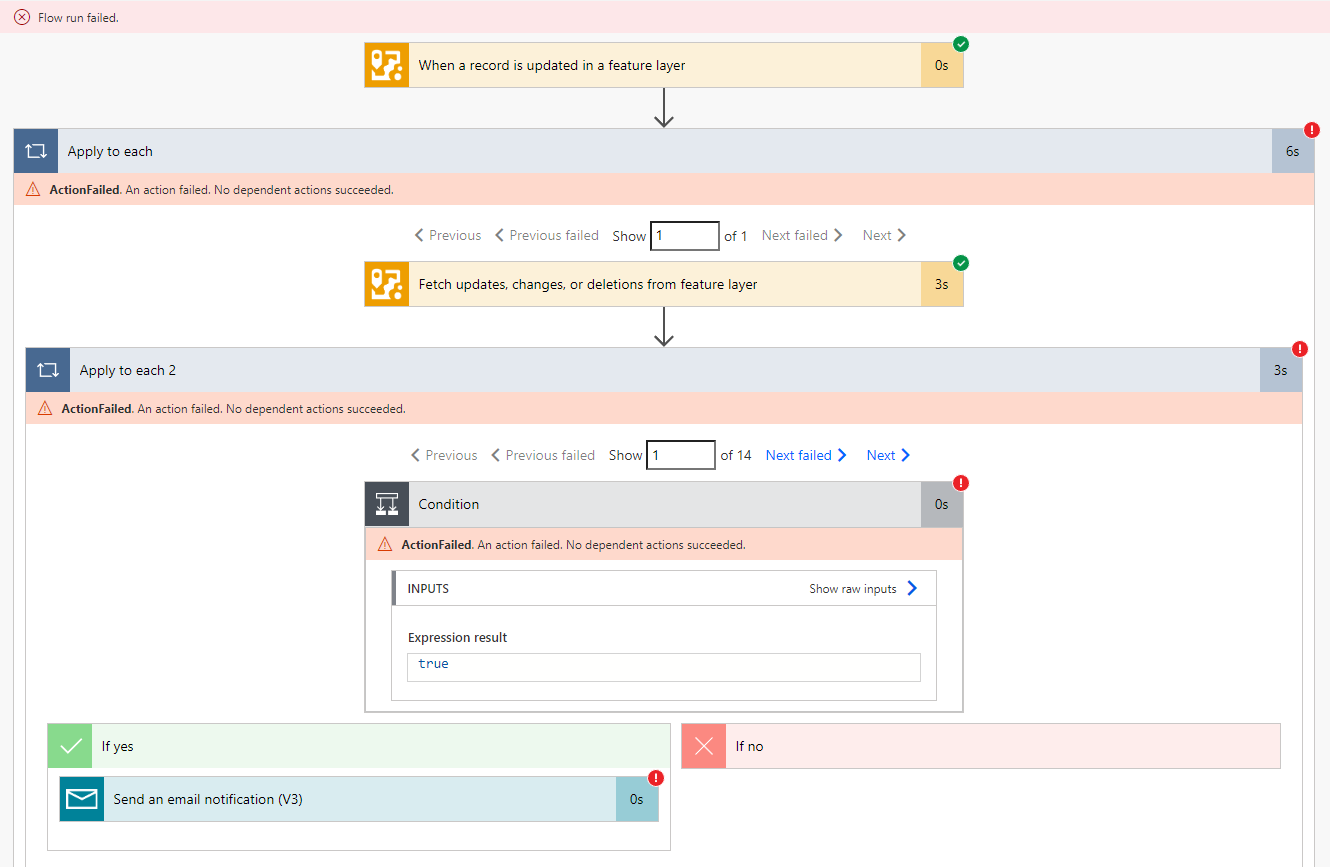

I've been struggling to get my flow working properly for a while now. I made some edits the other day and it seemed to be working but when I logged in this morning I see that my flow failed. I'm not exactly sure where or why especially since the results of my condition were true.
I see all kinds of red under the the Apply to each actions. I have never changed the values in those fields so don't understand why it has suddenly stopped working. Any ideas?

ahargreaves_FW

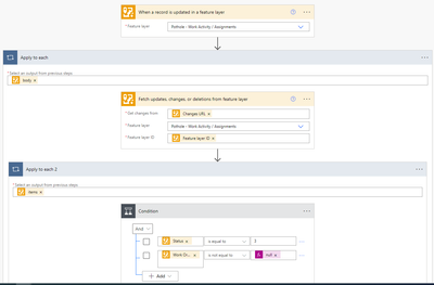

Here's my flow that is similar and works as expected.
can you show a screenshot of the 'raw input' for your condition?
SarahRijneke

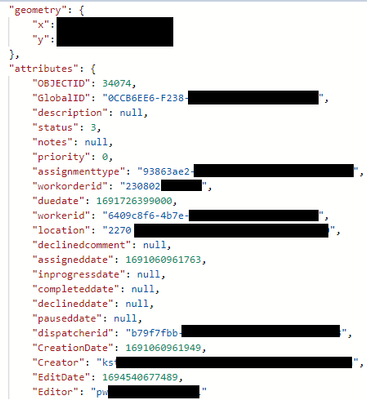

This is for one that should have failed (Status:3, Workorderid:null)
This one should have triggered an email (status:3, Workorderid: is not equal to null)

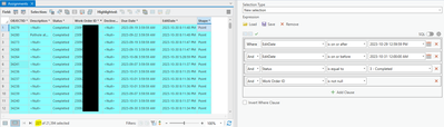

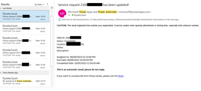

I am still experiencing this issue. I never get emails the first time the data is updated anymore (i.e. when the field worker changes the status to Completed). I saw 5 emails come through the other week when I bulk updated a field that was empty (8300+ records). When I query the table to match the conditions in my flow on the day that I updated the data I see that I should have received 227 emails.
