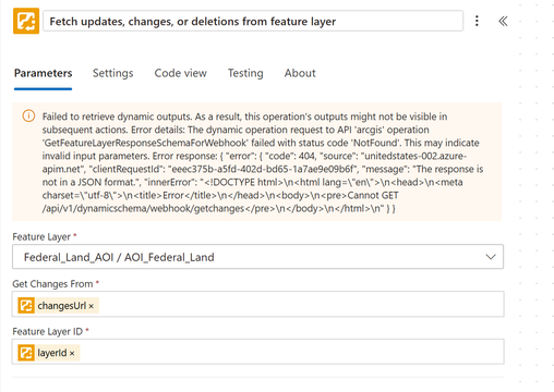

Hi All, I am having trouble with Webhooks to AGOL. I am getting the webhook error here:
In finding this and other blogs, it seems like it is related. All layers I have tried have tracking enabled, I have tried setting other permissions, and have even gone so far as using only layers out of my admin account.  My situation differs from Cat's in that this is my first go at a PA AGC where I am fetching fields.  My PA script to email me when a record is created works, but just not the field fetch.  Since I have never had it working, I am not 100% confident if I am doing something wrong or if there is a flaw.  It appears that it cant read the fields because the JSON isn't being returned properly.  Can you guys help?
AJD
I am getting the same error
KathrynWalker
Hi @AJD and @LisaT,
We have seen a few reports of similar behavior with webhooks in Power Automate and the error message:
Power Automate error message: Flow save failed with code 'DynamicOperationRequestClientFailure' and message 'The dynamic operation request to API 'arcgis' operation 'GetFeatureLayerResponseSchemaForWebhook' failed with status code 'NotFound'.
Some individuals have found improvement with their webhooks as of this morning.
If you are still seeing issues, would you be able to confirm if you are the error message above, share the feature service URL with me (can share here or private message me), and if there is a joined view layer with an area of interest defined?

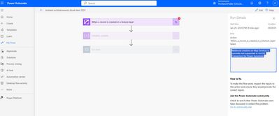

Hi @KathrynWalker  I was having trouble with my Enterprise 11.3 connections due to BUG-000169725
I created a new connection and was able to save my flow. Now I'm having similar issues as described above. When a record is created in a feature layer is not working as a trigger.
KathrynWalker
Hi @LeviCecil,
Do you know if the layer used in the trigger is a map image or feature layer shared as a reference? You may be running into BUG-000169327 for ArcGIS Connectors for Power Automate. If you contact Technical Support, an analyst should be able to confirm.
Thank you,
