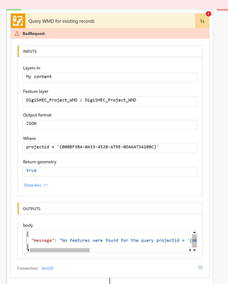

Hi all,
I am trying to run a query to make sure there is no data associated to an ID before I add it to a layer. I am using the get data tool and it is erroring because it finds no result however, this is OK. I want to prove the ID doesn't exist in the target layer.
Am I missing something with this? The rest API provides the message:
  "objectIdFieldName" : "objectid",
  "uniqueIdField" :
    "name" : "objectid",
    "isSystemMaintained" : true
  "globalIdFieldName" : "globalid",
  "serverGens" : {
    "minServerGen" : 505736,
    "serverGen" : 564265
  "features" : []
Obviously the response is fine when it finds records but this kills the whole task.
Hopefully someone out there knows something very simple to change.

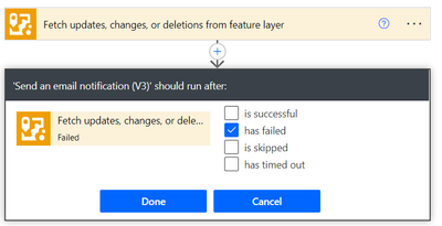

PhilLarkin1
Add another task, click on the menu button, choose Configure run after and choose failed
PhilLarkin1
GWaltersOZ
Hi @PhilLarkin1 that was brilliant thanks for that.
