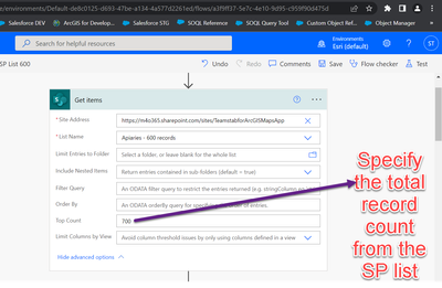

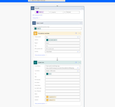

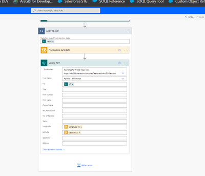

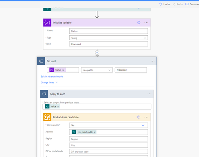

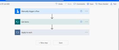

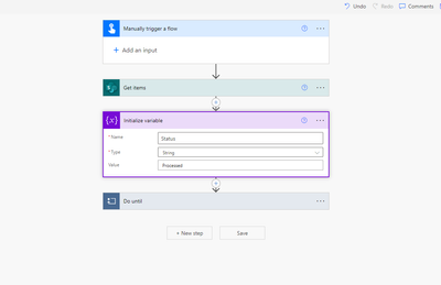

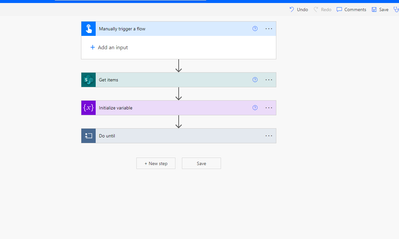

With regards to steps on how to use the "Find Address" ArcGIS Connector for Power Automate, I am attaching the below screenshots showing a flow I have set up to geocode a SP list with 600+ records.
Overall flow:
Each step explained:

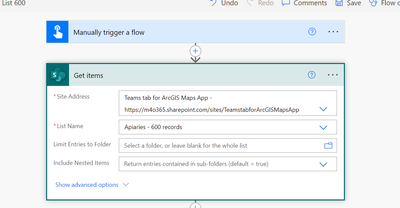

Get items from SP list
Initialize variable
"Do until"
I create the SP list with columns "longitude", "latitude" and "Status" (from an Excel table). The flow will populate the "longitude" and "latitude" columns and the "status" column is used to iterate the flow to process more than 150 records (avoid time out issue). The excel table used for creating the SP list has the column "status"  populated with the value "Processed" and this will allow the flow to run until it cannot find any records with the status="Processed".

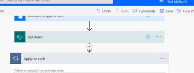

RaajRaaj
@FrancisHourigan1
I also wanted to share a simpler Power Automate flow which can geocode a SP list way faster than what I had shared earlier.
