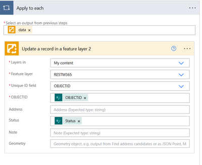

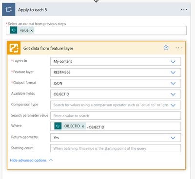

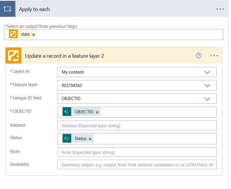

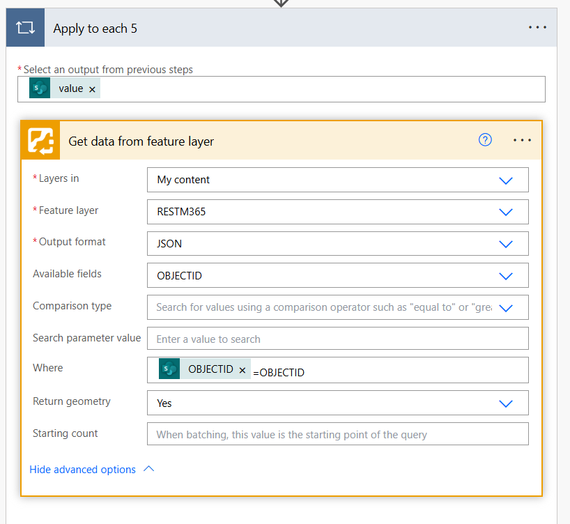

AkshayHarshe
@AaronPDXPaul Looking at your screenshot, are you updating an existing older flow? We updated the `Get data from feature layer action last release and it should include more options with different option names and placeholders, which I don't see. Try deleting and recreating the action. In Get data from feature layer action you can choose to use a `Where` clause but I think syntax should be something like
ObjectID=1234
Or if you are using dynamic content then:AkshayHarshe_2-1756309729224.png
Here is a simple example. I agree with all the comments made by @VenkataKondepati this is basically what he mentioned in a flow just using OBJECTID which in my case is FID
Hope that helps.
