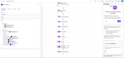

I am attaching an example of a flow that triggers from a Survey123 webhook, then uses the passed token to access and call common API methods on another feature service. The first screenshot shows a variable being defined with the feature update/edit json dict, then the second shows the actual HTTP request.
