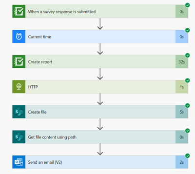

Hey @Beard_Greg, no worries - I appreciate your help! By the way, I fixed the issue. Turns out it wasn't a Power Automate issue or anything to do with the authentication. It was my report template. Somehow I tested it and it worked perfectly 3 months ago and revisiting it now, something was up with my syntax for one of the photos. Either way, so glad it is resolved.
My flow with the HTTP request actually directly uploads the created report to SharePoint, so it's an alternative approach to the method you show above. Here's my general flow:

Are these flows still working for you? I found this suggestion on another thread a little while ago and it had been working great. Unfortunately the PDFs in SharePoint are coming in empty now. It looks as if they are there, but the files are only 1KB now.
SeanKMcGinnis
@Beard_Greg - I am testing a number of different flows in support of UC presentations and am having no issues.
-sean
Sean McGinnis - Principal Product Manager, ArcGIS for Microsoft
Beard_Greg
Thanks for the quick reply. I'm not sure why it isn't working for me. I'm rebuilding using the ESRI's "Get Attachment" instead of using the HTTP. That seemed to have resolved my issue.
