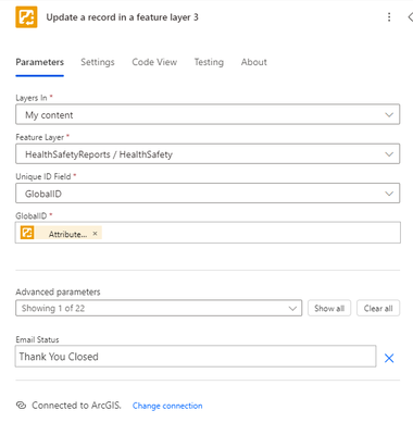

This is what works for me, using 'Update a record in a feature layer' action:
1. under 'Layer In'  - Specify you layer location (My Content)
2. under 'Feature Layer' - Select the layer you wish to update
3. under 'unique ID Field' - Specify unique id field (in my case its globalID), it could be a different field in your case
4. under 'GlobalID' - Specify GlobalID field (its required, you data must have globalID field)
5. under 'Advance Parameters' - Select field(s) you would like to update
6. next enter a value you would like to calculate (no quotes). In my case I'm updating Email Status field, and setting it to be equal to: Thank You Closed.
You will probably need to add condition before the 'Update a record...' step, so update happends only if the field is not populate, or whatever condition that you need.
I hope this helps.
