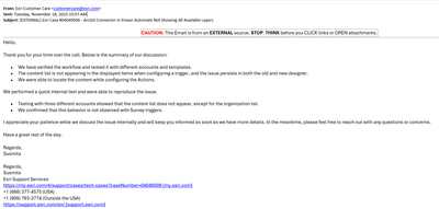

UPDATE 11/18
For anyone who comes across this post and is experiencing the same issue, ESRI was able to replicate the issue and they are looking into it.
Update 11/20
ESRI created a bug ticket for this issue, but based on @AkshayHarshe response below there may or may not be a bug. Just an opportunity to improve ArcGIS Connectors where specifying search in "My Content" or "My Organization" is not available to select such as the trigger and the connector "Fetch Updates, Changes, and Deletions". For now, the work around to use the feature layer REST service URL did work.

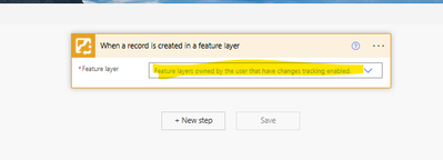

@AkshayHarshe. thank you for your reply. I will get back to you if we have over 1000 layers. In regards to your response, the help message in Power Automate is misleading then as it says "Feature layers owned by the user that have changes tracking enabled". this would lead me to believe I should only see feature layers that have tracking changes enabled   I tried typing in the service I was looking for with no luck and no reason it would be unavailable.

I see what you mean, The text still holds true and is phrased that way because we used to get many requests asking why the trigger is not working when the layers you select doesn't have those setting enabled. We are limited by power automate dropdown on how long the text can be. For some reason, when the text is longer than the dropdown it doesn't show a tool tip. I will see if we can revise the text.
