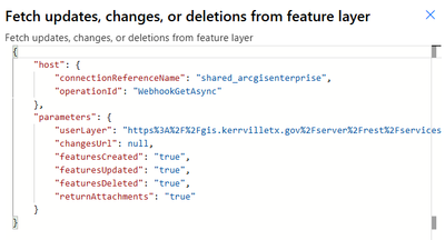

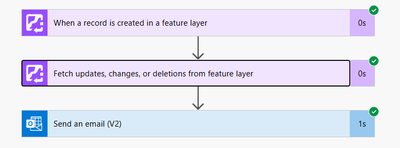

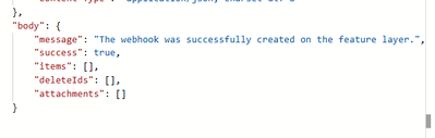

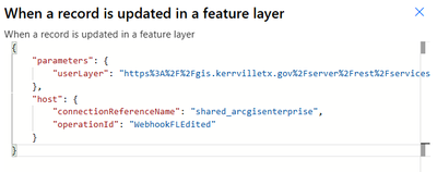

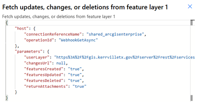

This is what I am seeing in Power Automate when I try testing the flow. I have changed current flow to trigger on updates instead of creation just to test what is wrong.
JoshuaYoung_0-1765900115776.pngJoshuaYoung_1-1765900195975.pngJoshuaYoung_2-1765900212515.pngJoshuaYoung_3-1765900227212.png
Nothing runs after the fetch step. I have tried the workflow described here https://www.esri.com/arcgis-blog/products/field-maps/field-mobility/automate-field-notifications-wit... and another here https://support.esri.com/en-us/knowledge-base/how-to-generate-automated-email-notifications-for-arcg...
The flow is active on ArcGIS Enterprise
I have also setup a similar flow on another hosted feature service. It has successfully emailed once, but the changesUrl was also blank. The difference is I am not looping through the items to send the email. However even with this flow, I have tried to trigger it many times, and I have only received one email.

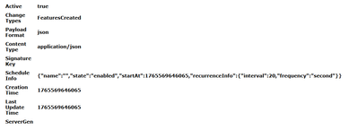

I checked the service webhook endpoint and the ServerGen field is blank on all of the webhooks I have made. Should that be the case?
The notificationStatus page is also blank for all of the webhooks.

@Joshua-Young If you change your trigger from Features Created to Features updated and save it then it will delete the old webhook and create a new one and you will run into following again:
Once the new webhook is created you will see a run with a message that `The webhook was successfully created on the feature layer`.  If you make a change to the feature layer to trigger your webhook the second run should return null response. All the changes you make to the feature layer after that should be received by the flow. This is expected behavior.
If you make several changes which triggered the flow a few times and you still don't see the changesURL populated then we might have an issue. Please let me know.

The serverGens value on the webhook endpoint does not show any thing.
