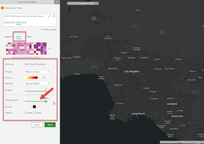

From your description, it looks like the color-coded map is created but not visible on the map. Can you please double check on your style options as shown below. I've seen cases where the transparency was set to 100 which causes the layer to disappear from the map.
