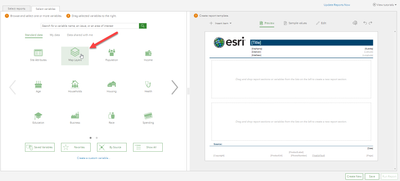

To see the "Map Layers" option in the data browser, you will need to add the layer to the map as you can see below.
In addition, the layer added must support feature query. For example above, notice I can click on one of the features and see the attributes list.

Thank you for this detailed reply and these useful tips. I read through your blog and am confused about how to use the "Map Layers" option. I am trying to build a new report and I do not see the "Map Layers" icon within the Select Variables tab within the report builder. Attached is a screenshot of what I am seeing on my end.
Do I need to be using a specific report template in order to see the "Map Layers" option appear?
