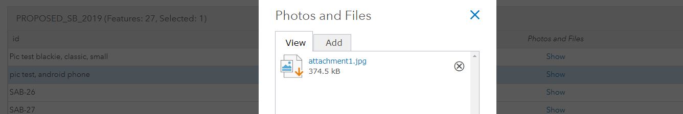

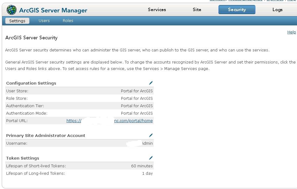

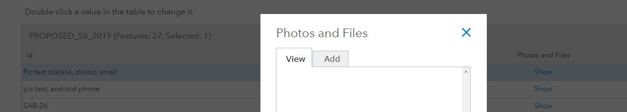

error messages and server manager snips below:
ipad error
android
