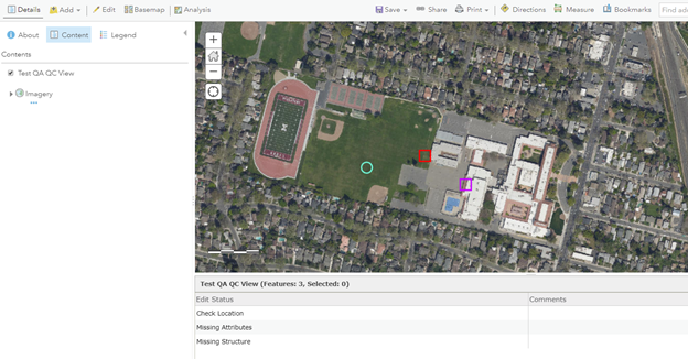

Example (part 1) - Two points exist in the database which were synced at different times from an offline map. Only one (left) is visible, while I can still select them both in the map and the attribute table shows two selected while only one is visible.

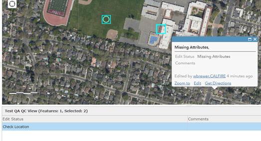

Example (part 2) - If I scroll in the other 'ghost' point becomes visible in the map, map but does still does nt appear in the attribute table even though it says 2 are selected.

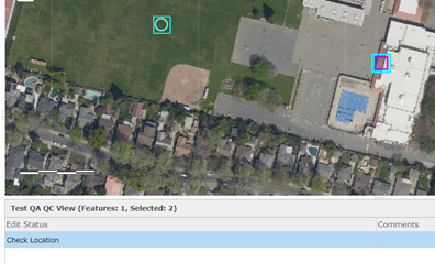

Example (part 3) - BUT when I add a record with the web map editor or Collector online, the view updates properly. All the records draw and the attribute table is correct. Below the red point was added through the edit tool and now all points are visible and 3 features are in the attribute table which is correct.
