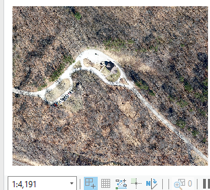

At this point its a matter of how good the data needs to appear to get the desired work done.   For example Level of detail 18 compression 20 the file size is 2.8 mb at source scale appears like this.
at 1:1099 it looks like this.
