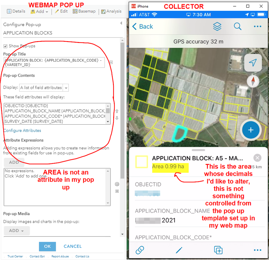

Is there a way to control the number of decimals in the area pop up of a collected polygon?
4410
6
06-16-2021 04:30 PM
AhnaMiller2
I am using Collector version 21.0.1
Our users do polygon mapping and reference the Area that appears in the pop up  (see attached screenshot) in  discussions with land owners where small fractions of acres or hectares matter.
Currently the area value is rounded to a single decimal. Is Collector Classic, the area value appears to be rounded to the nearest 3 decimals.
Is there a way to control somewhere in the settings the number of decimals the area value at the top of a pop up will have?

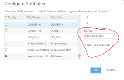

ArcGIS Collector is powered by web maps in ArcGIS Online correct? You can control that in the web map pop up if so.

AhnaMiller2
Thank you both @MatthewBrown8 and @Anonymous User
This does not quite capture the question I have, but  appreciate your input. The area I am referencing is not part of a manual pop up I have created from the webmap, but is automatically generated by collector as a reference

Hi Ahna:
Is there an area or shape area field at all? You still might want to try adjusting the decimals for that area field attribute in your popup configuration even if it is unchecked or not being displayed in the popup. I would otherwise suggest posting another question if that does not work so others with additional knowledge of the collector configurations can respond.

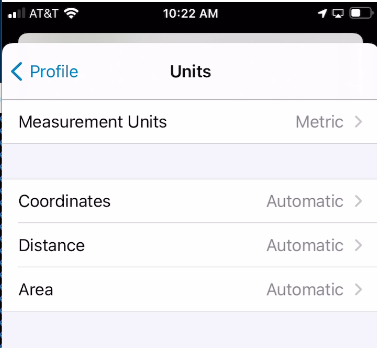

Our workflow: a user will go to the field along with a field manager. They will sit with the manager to fill in the attributes of the field and will verify that the acres look correct. The higher numbers of decimals is particularly useful when we map very small areas- as low as 0.125 acres or lower 0.012 acres. We are  using the automatic measurement units from the profile on collector.
