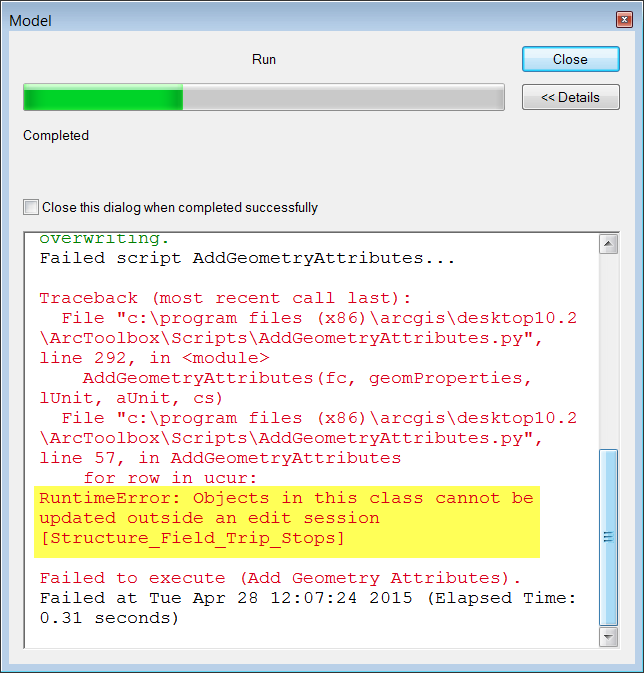

Hey Dave, it appears that the relationship class is causing the Calculate Geometry tool to be inactive. In order to activate the Calculate Geometry tool you have to begin an edit session. Not sure the exact cause and affect here but I was able to calculate the geometry inside of an edit session within ArcMap. Try it on your end.
BenGrod
Dave, I tried putting this into a model which would add the fields and calculate geometry. The model returned a RuntimeError: Objects in this class cannot be updated outside an edit session. If you want to use this data structure and automate the process I believe you will have to write the code in Python, I think you can activate an edit session in Python (someone please correct me if I am wrong). You may find some help by posting a separate discussion in the Python Group to ask for a script to add fields, calculate geometry, and whatever else you might need. Nice working with you and good luck

BenGrod
Dave, if you disable the relationship class in your geodatabase you can calculate geometry outside of an edit session, I tested this out. The relationship class is your limitation in this scenario.
