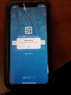

Hi, I am getting this error "cannot connect to server" in iOS with field maps when users in my organization click to sign in. Has anyone else experienced this behaviour? the iOS is up to date as well as field maps.

ShannonJ
@GlenShepherd
signing in through the browser on the phone works fine - I just tested it. But as soon as I click "sign in with ArcGIS Online" on the field maps app this is the pop up
GlenShepherd
Thanks for the screenshot and testing. Are these work devices? Are they all the same iOS model, and if so, what is it?
Can you test the same workflow with a personal device?
Is there a VPN in play here, or any other network security to be aware of?
ShannonJ
These are work devices, there is a VPN and we use vmware verify as well as other security measures I'm sure - the phone profiles are managed by our Info. sys. dept., and I don't have all the details on that. On my personal device I have no issue logging in.
The iOS is up to date on the phones i have been testing - updating the iOS is always my first check. I'm not 100% sure what model the phones are, i believe they are iphone 10.
GlenShepherd
Being that you have no issue on your personal device, it would seem clear that there is some network configuration within your organisation preventing the mobile device making requests to the server through the app.
I would reach out to your IT department describing the issue and they should be able to conduct a network capture to diagnose the connectivity. It might help to point them towards the following white papers:
