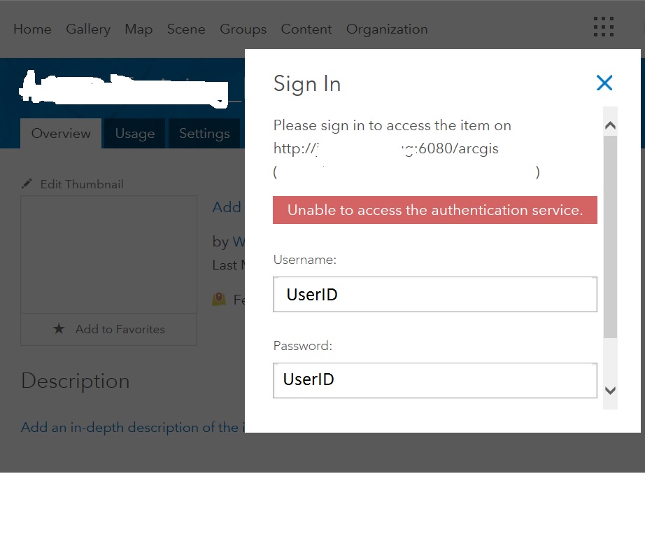

JoseSanchez
Hello everyone,
Can you explain how to " set up a user & role for that will be applied against the service"
With the option "Users from an existing enterprise system (LDAP or Windows Domain) and roles from ArcGIS Server's built-in store"  I am able to use Active directlroy users, and when I open the map the Feature Layer shows and it is editable.
but with the option "Users and roles from ArcGIS Server's built-in store" I already created an user in ArcGIS Server, but I can not log it, it shows the error message: "Unable to access the authenticated service"
Lake_Worth_BeachAdmin
most likely need a CA cert or in Server admin directory set it to http only as well in your web server default site
