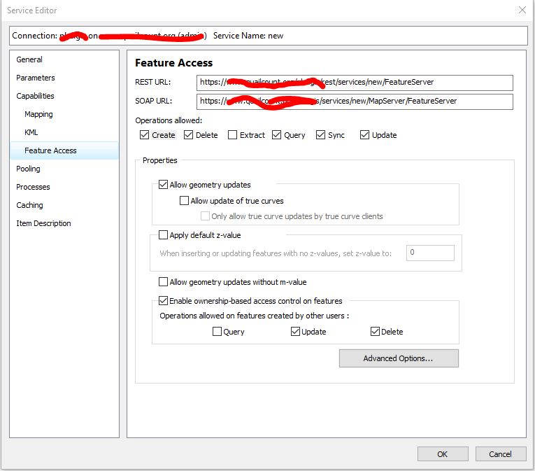

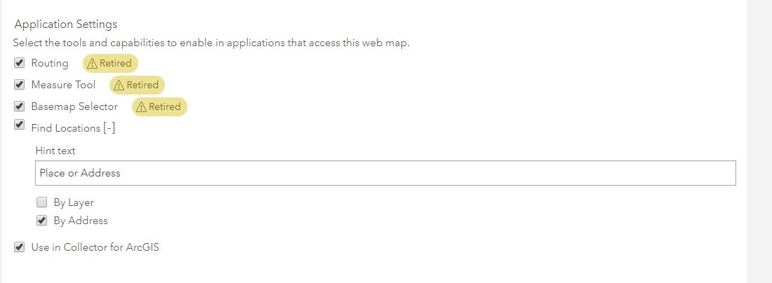

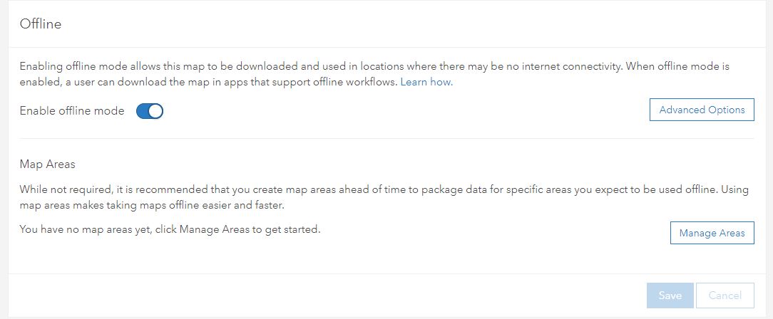

I have setup my feature services to be editable, enabled sync, enabled editor tracking, enabled archiving, enabled globalIDs. I am using an ESRI basemap. My web map has "Offline" toggled on. I use my web adaptor to add services to the web map so the services appear in the web map on Collector. I can't figure out why my "Download" button is grayed out when trying to choose a work area. Note, I am talking about the download button after clicking the cloud icon. I can see the features and basemap, it just won't let me download it to my device.
MKF62
You have to set the Map Detail first. Once I switch the Map Detail view, the download button turns white and I can download it. I can also switch back to Work Area after clicking Map Detail and the download button will remain available.

I have encountered this problem however I believe its a more technical issue. I had no issues downloading maps before. The "Download" buttons stays grayed out no matter what I do.
Does anyone have any insight?
Thanks in advance!
GideonDalrymple
Found the problem. I could not download the basemap because I was not signed in with ArcGIS online account. I was running portal.
