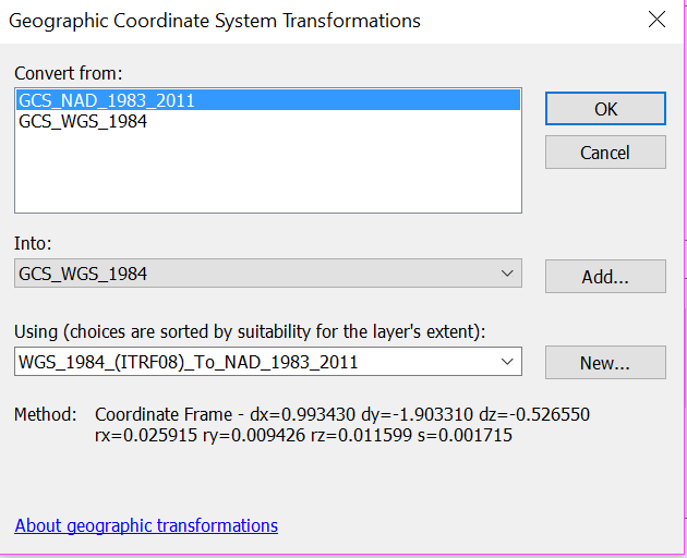

MiaogengZhang
Different publish methods can affect the spatial reference of feature service, which will change the spatial reference of exported file geodatabase.
If you have File GDB with NAD83 2011 and upload zip file into ArcGIS Online, the data is reprojected into WGS_1984_Web_Mercator_Auxiliary_Sphere. When you export File GDB from this feature service, the spatial reference of exported File GDB will become WGS_1984_Web_Mercator_Auxiliary_Sphere, which is different from your original NAD83_2011. In this case, you need to make sure in ArcMap, you need to configure geographic coordinate system transformation during data comparison.
If you would like to have the same spatial reference between exported File GDB and the original File GDB, you should use ArcMap or ArcGIS Pro to publish feature service and make sure data frame in ArcMap or Coordinate System in Pro Map Properties to be the same as original File GDB.
