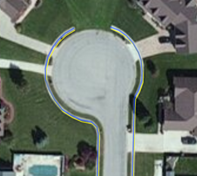

We used Collector to digitize sidewalks in the field. The lines were drawn on the map using the editing tools - meaning the GPS location was not used. The original data (File Geodatabase) was in NAD 83 Ohio SP South (ESRI:102723) when uploaded. On the AGOL map, the sidewalk lines line up with the imagery. However, when exported as a FGDB, downloaded and opened in ArcMap and viewed with 1ft ortho imagery, the data is incorrect. It looks as though it has been reprojected. The screenshot below shows the AGOL data - BLUE - direct from the AGOL Feature Server service and the exported data - YELLOW - (exported from AGOL) on a Leaflet map, using the ESRI imagery basemap layer, the same imagery that is used the AGOL maps.
Also, if I export the data from AGOL as geojson, I get again different results. Currently it is unclear how I can get my data out of AGOL without drastically impacting its spatial accuracy. Maybe I can reproject it in ArcMap, or change the projection?
Any idea what is going on here?

So it looks like exporting to GeoJson keeps the file in WGS84. Then you can open that geojson file in QGIS and export to shapefile form there. This gives better results. Red is geojson-to-shapefile, yellow is the exported FGDB. The FGDB is off by sometimes three feet.
Wow.
