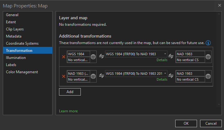

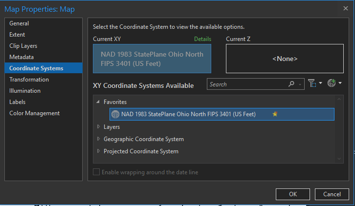

Unfortunately, I do not know of any supporting documentation for transformations.  I typically start by positively confirming the coordinate system of the source data and using a known reference to confirm the proper transformation.  Experiment using a logical progression the system would have undergone until you find a transformation combination that works.  The process can be a challenge, especially from an older system to a newer system.
On a side note, the transformations listed in ArcGIS are typically in the order of most likely to least likely. Provided you have set your map to the desired coordinate system.
Sorry, I did not have any data available on my home system to demo correctly.
