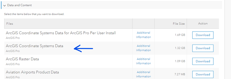

Out of curiosity, have you applied the most recent ArcGIS Coordinate System Data to your ArcGIS Desktop or Pro installation.  This is available from your my.esri.com page under downloads, data and content, and will provide the most comprehensive set of transformations with the newest data.
