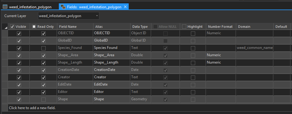

  • I double checked the table after the change of owner, the domain and fields etc seem to be intact:
I am kind of stuck and unsure what to look for!

I just provided an edit to my original post, but Pro has provided more information. I am still confused as to why. It is telling me:
But I have no idea why it is referencing these column names, they do not exist in my table, nor do I think they ever have... very confusing!

From the actions you've taken I really have no idea how this could have happened. Somehow your editor tracking seems to been trying to store the information in fields that don't exist - the only way this is possible in my understanding is if you:
  • Published a service with editor tracking fields but without editor tracking enabled
  • Enabled editor tracking in AGOL, which may create duplicate fields (e.g. Creator_1) instead of pointing to the existing fields
  • Deleted the duplicate editor tracking fields
And I don't even know if it would allow you to do that.
We can check which fields editor tracking are pointing to to confirm this:
  1. If you go to the item for that feature service in AGOL, in the bottom right click "View" by the URL box to view the rest endpoint
  2. In the middle of the resulting URL add "admin" like this: arcgis/rest/services/ -> arcgis/rest/admin/services which opens that service with the ArcGIS Rest Administrator
  3. At the bottom of the page click on "Update Definition" (we're not going to change anything just yet so don't worry)
  4. Ctrl f search for "editFieldsInfo" which will take you to the part of the service definition where it defines the names of the editor tracking fields
Let me know what it says for the different fields, I'm guessing this will say Creator_1, EditDate_1 etc.,
Also if you haven't got a backup of the data in the service I'd strongly recommend doing that now before trying to fix this.

I have followed the steps you have outlined, and I can see the below results, I do no think this is what you were hoping to see?
JoshuaSharp-Heward
With every post I feel a little more confused. I think it's probably worth trying publishing a new editable service with that schema and seeing whether the resulting service has the same issue. Based on the ArcGIS Pro error you were getting I still think it's trying to write to some editor tracking fields which don't exist, which would explain the behaviour you've been experiencing with the edit failing at submission. Disabling editor tracking and trying to digitise a feature might be enlightening?
Also if you search for "CreationDate_1" in the service definition does it return anything?

So I just added those columns into my table (Creator_1 etc), and now I am able to submit data no worries. Both pro and collector are saving data again.
I have also looked at the table to see if these newly created columns are being used, and I can confirm they are not being populated at all.
Editor tracking IS indeed turned on, but it is using the standard columns as expected.
