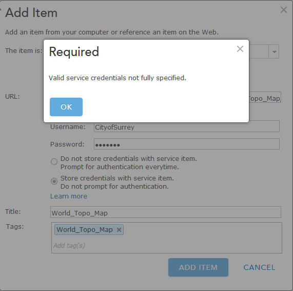

I get this error while trying to add the map service...perhaps I should create my own?

JamesGustine
Hi Russ,
Are you required to have a pay account to access the tiled basemaps? We have portal 10.2.2 setup and I'm trying to add these tiled services as items to our portal, but I keep getting valid service creditials errors. I'm using a free AGOL account and we use only HTTPS so I have that in the service URL. We already pay for portal, so I would be unexpected that this needs to be a paid organizational account.
Thanks,
james
RussRoberts
Esri Notable Contributor
Yes, to access the tiledbasemaps services you need to have an org account as well.
