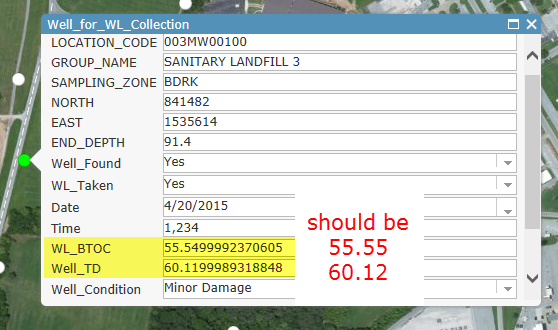

Actually, they only appear to have been updated correctly.  When you click the well point, in the pop-up you see 55.55.  But if you then click edit, you will see that the number that is actually in the field is 54.54999......
MiaogengZhang
I can reproduce this issue now. It happens in offline map mode. That is rounding error of float field/double field. Internally we have an issue to track this.
