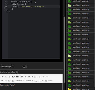

In the return, you only need to set the attribute "total" to the variable "total". In other words:
return {
attributes: {
total: total
And then put "{expression/total}" in the line item template down below the code section.

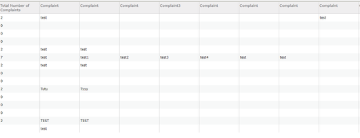

Yes "complaint count" (total number of complaints) is an attribute on my hosted feature layer.  Ideally, it adds the complaints every time a complaint is entered. But in reality, it only adds them when I re enter the SQL expression in the calculate field in the "complaint count" attribute.

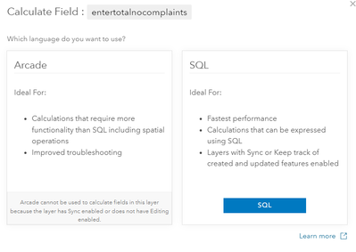

The calculation in SQL works fine, just doesn't update when a NEW complaint is added. Plus it appears I cannot use Arcade as an option.  Note it states that Arcade cannot be used because Sync enabled or does not have editing enabled.  Both layers I unchecked Sync enabled and both are editable. So I am not sure why its not allowing me to use Arcade. At any rate, the SQL expression works except for NEW values.

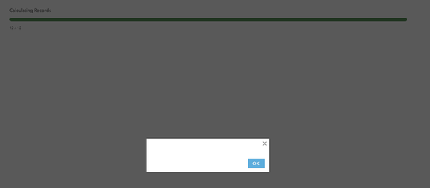

2.  I then tried it in the map viewer and I got this.

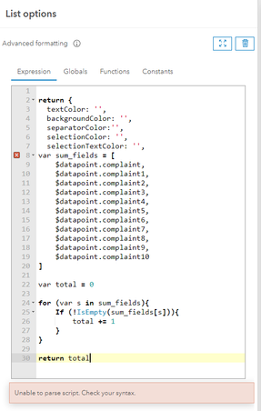

3. Then I tried in the dashboard Arcade, but this is what I got. I did change the field names to the correct field names, hence the $datapoint. I don't know enough to know what is wrong. Any  help is appreciated.

So, in a dashboard's Advanced Formatting profile, your expression will have to go above the return section.
// Your expression
var total = 0
... etc ...
// The return. Unless you need to change the background / text color based on some attribute, you can leave those off.
return {
   attributes: {
     total: total
Then in your list item's formatting, reference your custom attribute as {expression/total} and you'll see it populate in the list.
