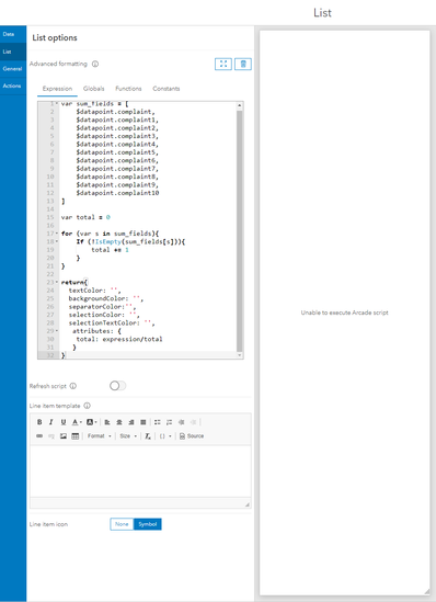

This is what it looks like now, but indicates 'unable to execute Arcade script"

You're so close! Just a minor tweak and you'll have it.
In the return, you only need to set the attribute "total" to the variable "total". In other words:
return {
attributes: {
total: total
And then put "{expression/total}" in the line item template down below the code section.
