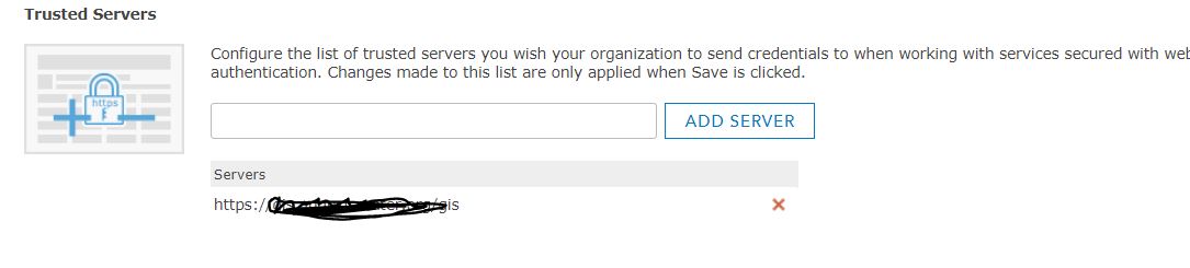

What kind of users are you using in ArcGIS Server Manager (go to Site->Security). Also, do you have your server listed as a trusted server in ArcGIS Online?
AlinaTaus
