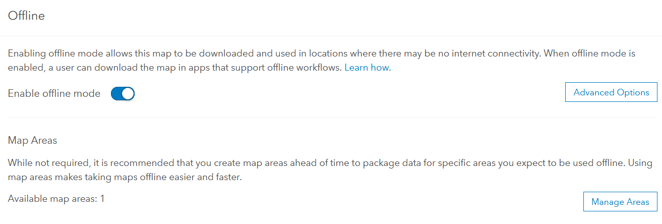

Once I have saved the map, I enable the 'offline mode' for the Web Map in AGOL.

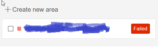

I tried to create a an 'area' which will be available to download for offline working, but I have an issue with 'Packing'.

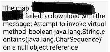

I can see this area in Arc Collector/ Collector Classic, but once I tried to download it there is an error message 'An error occured downloading the map area' i Arc Collector and below in Collector Classic:
I have also tried to 'Add offline area' directly in Arc Collector/ COllector Classic, receiving the same messages.
