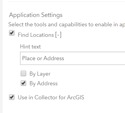

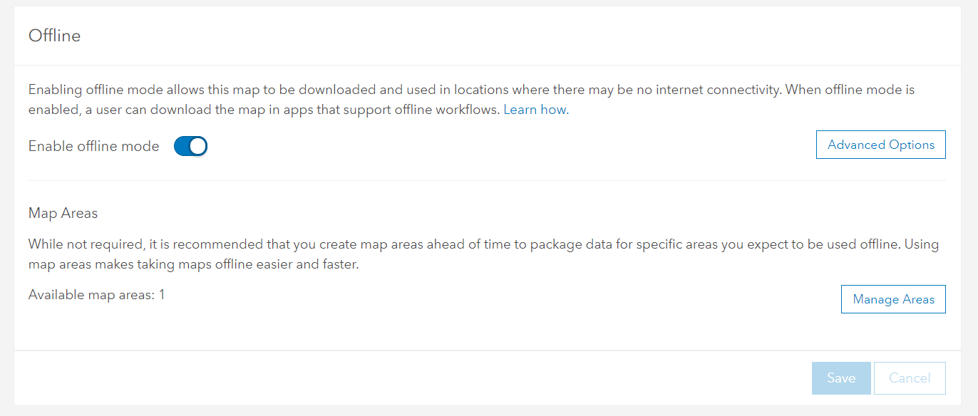

Wade,
Under the settings of the map's item details page, do you see these options for enabling offline mode and "Use in Collector for ArcGIS"?

WadeWall
Hi Katherine,
I don’t see those options, but I may be looking in the wrong place. When I go to "MyMap", I can click on settings on the right and those options aren’t available. I can see headings like “General”,”Delete Protection”, and “Web map”.
