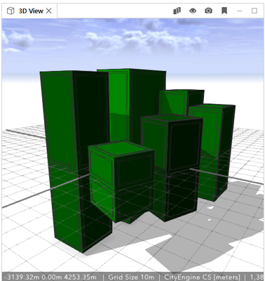

I have modified the code you provided, but I believe it might not produce the intended result. The current outcome is due to applying setbacks simultaneously to a single parcel. It is better to use the 'selector' to distinguish areas for the offset and setback commands, and apply setbacks step by step while progressing through the rule for each area.

I hope this helps.

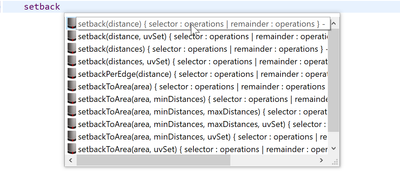

At this point it also needs to be mentioned, that those "unexpected token" errors generally occur when using a wrong syntax in a previous code statement. It is always a good idea to consult the online help. Usually there are also code snippets provided that show common usage.
Also the code completion feature (hit <ctrl + space> while typing) can help finding the right syntax.

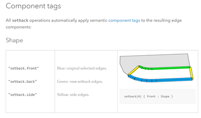

setback operation—ArcGIS CityEngine Resources | Documentation
