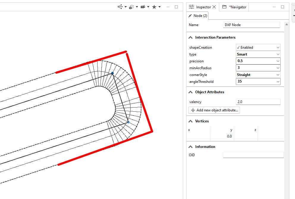

Hello dear community! Please check attached image. As you can see I have street with a rounded inner and outer radius. How can I round inner radius only? The red lines indicate the expected result in the screenshot.
I tried changing the minArcRadius and cornerStyle value. But it didn't help

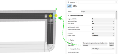

ThomasFuchs
Hello @corintho
Thank you for your question. Unfortunately only the inner curb radius can be changed to be a corner. However, there is a "creative" way to get your desired result. You can can turn the road bend into a T-crossing by adding a tiny segment. Then assign "Sidewalk" as a start rule to the street segment.
