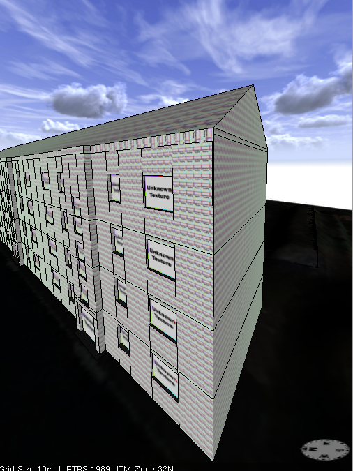

I had a complete model (CGA rules, textures...) on City Engine and I needed to change some fields related to the footprints shape so:
1. I modified the footprint file on ArcGIS and imported it back to CityEngine as a GDB file
2. City Engine read the CGA rules associated to each building but not the textures
Does anybody know why is that? The rules are perfectly written specifying the exact path to the Images. I left the original layer on the scene (it has the same rules and shows the textures) and it works perfectly. The imported one doesn´t read the textures...
I hope somebody can help me. Thank you

On the inspector this is shown for the building 627334:
CherylLau
