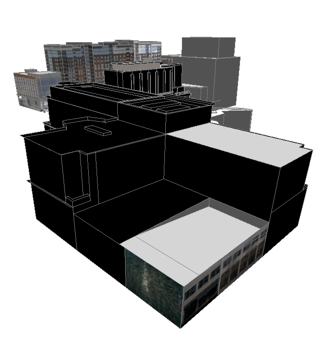

I opened this thread last year and never really found a solution and though it continued to happen off and on, I could continually restart CE and finally get it to work.  However this approach doesn't seem to be working anymore.  Nothing has changed with my computer setup or specs.  It also doesn't even affect all of the facades with the same texture file path (see attached).  It's quite irritating and fairly significant efficiency drag.  Any ideas?

Again, the thing that's odd is that the issue only happens some of the time and seemingly random.  To give another example, I just had the following happen to me this morning.  I opened CE and saw what you can see in Image 1.  The black areas are facades that I have applied textures too and you can see the file path of the image.  Everything seems fine except it just doesn't show up.
I shut down CE and immediately reopened, no other changes, and encountered Image 2.  Everything works again.  If the issue was simply a matter of rebooting CE, it would be a hassle but I could live with it, however I've recently encountered a few situations where I've rebooted CE multiple (i.e., 5) times and rebooted the computer itself a few times and the facades are still black.
